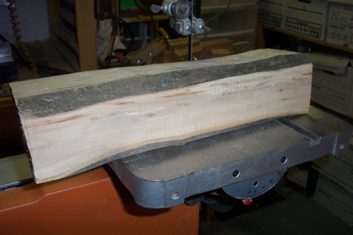

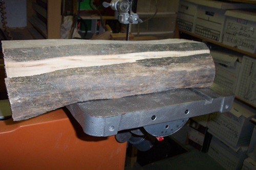

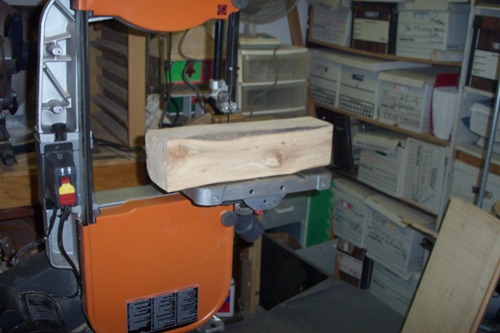

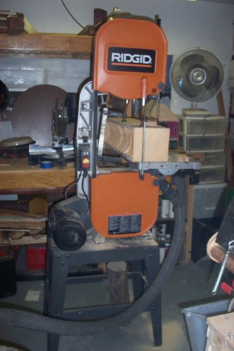

Yeah bud, yer gonna have a lot of fun with your big new toy! I finished installing my riser block tonight and practiced on a bunch of scraps, i had an old pine plank that was 11" wide by 3" long by 1/2" thick and resawed it in half, then i started squaring a log of i dunno whut that i might use for neck and end blocks, pretty dense stuff but still easy to cut! Loves ma bandsaw!
Here's the improvised fence i used tonight, i'm gonna buy me a decent one tomorrow.

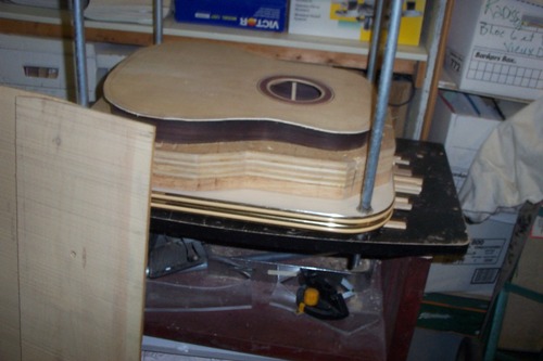

in the next pics, you can see the pine plates leaning against the purple desk that's under the go bar deck

Can you tell us more about what you needed to do to iinstall the riser block and how well the saw cuts with it? I have the exact same saw and have been debating whether or not to get the riser block.
Cheers!
PostPosted: Sat May 13, 2006 12:11 am
Hi John, it's really simple but you still have to follow the instructions that RIDGID provides in the riser block package and also go back to the original instruction booklet of the saw for resetting everything afterwards.
To install the riser block, you first have to loosen your blade, take the table pin out and the plastic round piece and out the blade goes. You then have to shim the upper arm of the saw and unscrew that big bolt that's behind your on/off switch, the upper arm being heavy , it could easily fall to the side with the weight of the wheel. With the riser block package comes a bunch of adjusted new parts that you'll have to install, one word of advice, read the whole paragraph instead of reading a sentence and try to to it a bit at a time, when installing that blade guide assembly especially. The 105" blade provided with the riser block is not the best quality but good enough for practicing and yes, get yourself a decent fence!
